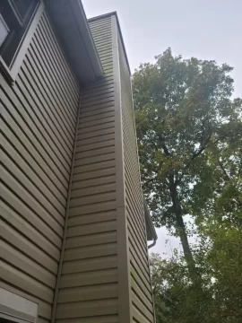

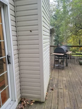

So here is my current setup. I have a guy coming over in a few weeks, to look at my set up and determine what has to be done to get me a fireplace I can use again. As you see it is situated on my rear wall, and the bump out on the deck is where the firebox and flue is located. Its approc 20 feet high. My general questions would be, is a zero clearance fireplace the same as a woodstove? not sure of some of the terminology in use today. Thanks for any imput you may have.

ZC fireplaces and wood stoves are quite different, though the difference gets much smaller with some modern EPA fireplaces. Some are actually made by stove makers that have adapted their firebox to a ZC configuration. The Pacific Energy FP30 and Osburn Stratford II are examples of this.
That said, there are ZC fireplaces that are simple fireplaces that produce little heat and suck that out of the room as they are cooling down.
