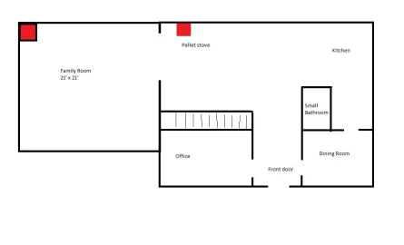

1300 sqft is a big house. Especially if you're trying to heat the upstairs. What is the layout (can you draw a plan?)? What kind of stove are you looking for: cast iron or steel? Price range? Where do you live?
Andrew
That's exactly why I was thinking larger stove, I guess you can never have too much. Not really sure on the style stove, price range really doesn't matter as I won't be installing it until fall of next year and will have plenty of time to save for it. I live in the eastern panhandle of WV. Just west of Martinsburg to be exact. I'll try to get a drawing up of the downstairs layout

Based on the floor plan you drew - I personally would not go for the big Englander or any other huge stove like that for that corner of the room. Its a corner after all.
Although I don't run one - I'd look at a nice soapstone/cat stove - something with decent burn times and the ability to throttle down.
