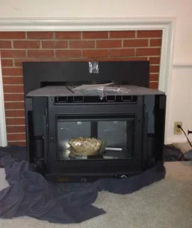

I currently have a Neo 2.5 in my living room which is nice to look at but not actually moved into the fire place yet. It was freshly built (July 2014), but I am nervous about the decision to go with uninsulated 5.0 liner. I understand that represents a significant drop in volume.

  • [Hearth.com] Neo 2.5 Install Questions
