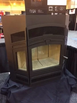

I did take pic of the RSF when I was at the show. It is a beast. Don't remember seeing any other stove entries.
