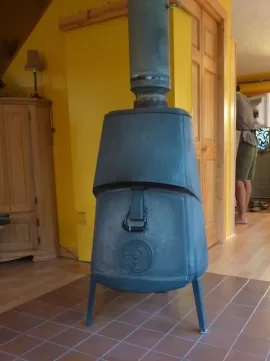

I currently have an older Jotul Combifire #4 wood stove that I would like to upgrade to an EPA certified, non-catalytic, clean burning wood stove.
The current stove is configured with 8" metalbestos stove pipe which extends through the first floor, second floor, then through an unheated attic, for a total length of 24' with no bends. The stove pipe is in good condition and has only been used occasionally in the fifteen years since it's installation. We cleaned the stovepipe recently and got about a grapefruit sized mass of creosote (last cleaning was about 5 years earlier). It looks like there is an adapter right at the stove that increases from 6" or 7" to the 8" stove pipe (this is what came with the house).

You should be fine using the 8 inch pipe. 6" pipe is 28sq in. and 8" is 50sq in. well below the 2.5 x greater which would be 70 sq in.

They were trying to sell you something you didn't need (IMO). I ran my Regency with 6 inch pipe to an 8 inch wall thimble to an outside 7x7 clay flue without an ounce of issue. Your going strait up and out which is ideal.

Too bad you have to say goodbye to the old Jotul, they are so cool looking, like Easter Island statues!
Ah, you know my Jotul well. Yes the Easter Islander looks is very cool indeed. But I am looking forward to a window, a flat top that can be used to heat things, and stuffing less wood into it!
