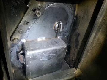

I have had a lot of problems with the metal cover over the combustion fan on my new 52i. My cover is currently sealed in place with a sealant called Mill-Pac. It was a temporary fix to the problem that worked. Basically what is happening is the cover is a poor fit and it not pushing enough air through the burn pot.I have attached a photo of the seal cover. Please note the tabs were welded on to break the cover lose to clean the fan and exhaust port.
  • [Hearth.com] New Accentra Insert Having Trouble Igniting
