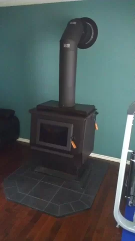

Even though it is a Blaze King, we still need a picture. Just for proof ;)
Break in fires? Umm, of course :)

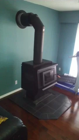

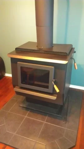

Here is the stove.

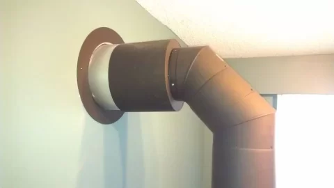

And here is the part I don't like about the install. Not sure if it is an Excel product problem, or, the installers didn't bring the correct part, but, the black outer sleeve is too short. Don't know if there is a longer sleeve available or not.

That looks like they brought too long a horiz. pipe off of the tee, like an 18" instead of a 12".
I'd ask the installer to put in the right sized part.
You could easily paint it with black stove paint....
You know, that looks very nice! A rarity for BK's! ;)

It probably has to do with some stove pipe heat clearance thing........I would just call them and ask them why they did it that way..
I would just paint it like Machria said.
Blaze King should come and take some photos of your setup and use them on a new brochure ....they would probably sell more of them. :) ........ Looks Great. !

By looking at the glass it looks like everything is going just as it should for a BK. ;lol
+1. My install uses the Excel piece like the OPs, and you cannot see any of the thimble. The black piece actually goes part way into the wall. The horizontal pipe length is what sets the distance.
Is the vertical pipe not actually plumb? It looks tilted in the photo. Really doesn't look like it was installed right. As said, looks like that thimble should be more in the wall. And if that's how professional installers do it, I think I'd want to do it myself (but then what do I know -- my only experience is with inserts and liners).

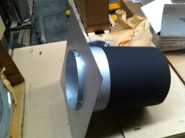

What you are seeing is a wall radiation shield. The black piece telescopes over it, it's made for all different wall thicknesses. They simply should have trimmed it back or painted it. No big deal. It's a double wall piece and the chimney passes through it. It could have been shorter, but then they would have used a piece of double wall pipe Instead. Same end result.
So that flange is bolted to the outside of the house and the longer side of the galvinized shield passes into the wall? It must be that long to be usable on a 12" thick wall!
Yes, I realize that. There are an 18" and a 12" shield. The one they installed was the 18". If, they had used the 12", it would not have been a problem, and the black sleeve would have slid right into the wall. Not a problem.
Yes, but it still isn't a problem. They used what they had with them.
