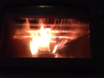

Hey All,
The wife and I bought our first wood stove this fall, a Buck 81. We love it so far and have been using it as our sole source of heat in our 2,400 sq ft. home.
My question is related to stove temperature and efficient burning. Our stove installers gave us a Rutland stove pipe thermometer and it seems to spend a lot of time in the creosote zone.
But the fire seems hot, I'm seeing secondary burns, and the house is staying warm. Check it out on the video below.
http://youtu.be/odFLLTgkNnw
I gave a call to Buck and they said that the Rutland stove pipe thermometers are a bit outdated and aren't the best indicators for new, efficient stoves.
What do you guys think?
And also, thanks for an awesome forum. I've been lurking for a while!
OK, it's heating up a little... But just barely into the burn zone.
These fires seem modest in size. How long had the fire been burning? Is that single or double-wall pipe connector?
Oh, and welcome!
Single wall pipe, the fire has been burning about an hour and a half.
Could be the thermometer, but perhaps the fire is just too small?
Can you take the thermometer off the flue collar and put it temporarily on the stove top, a few inches in front of the collar? Note,the normal location for the flue thermometer is 12-18" above the flue collar.
Thanks begreen. The temps around here were in the mid 40's today so I didn't build as big of a fire as I typically do. Even with a big fire I'll get a good burn zone needle for about an hour, and then the rest of the time the needle hovers just around the burn zone creosote zone, unless I've got the air going full tilt.
I put the thermometer on the stove top and the temp went down a bit.
I'm thinking about purchasing an IR thermometer, if I do what type of temps should I be looking for for the stove, stove top, flue pipe?

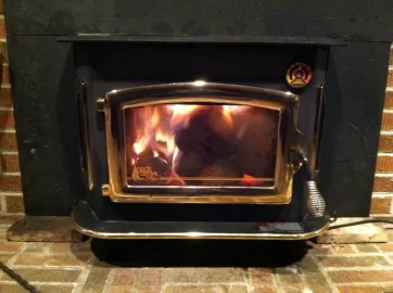

The stove top is not a good place because it jacketed. On the front or side is best. I run my 74 to 500-600+. This pic is not mine it's a friends and shows a better place for the thermo. Those thermos can be quite inaccurate. By the laser and find the hottest spot. This is an insert install:
Welcome. That fire looks kind of small to me that may explain your flue temp..
The stove top is not a good place because it jacketed. On the front or side is best. I run my 74 to 500-600+. This pic is not mine it's a friends and shows a better place for the thermo. Those thermos can be quite inaccurate. By the laser and find the hottest spot. This is an insert install:View attachment 88747
Thanks for the tip on placing the thermometer on the door. The needle went right up to the creosote/burn junction. I just put some more wood in and we're right across into the burn zone for the moment. It seems like a tough line as far as how big to build the fire when the house is warm and you don't need much to keep it that way.
I'm not too far from you down in Pittsburgh, just up I-79 towards Meadville and Cambridge Springs.
I am down 79s in Washington, pa. I leaned here that the internal temp of single wall is 1.5 to 2 times higher, potentially. A probe type thermo is much better for your application. You can check the thermo you have accuracy by boiling water and dipping it. Don't set it in, dip tongs or something. I verified that with a laser thermo.
If house is warm, then make small hot fires not big smoldering ones! You may find adding a piece at a time or loading full and burning till coals works best. But you get that baby up to 650ish, you will sweat or open a window!:-)
I've got the thermometer on the front of the unit above the door, I've got close clearance shields on the sides... With the fan turned off the needle is solidly in the burn zone, which makes me happy. It's running around 350 on the upper number and now I'll know that when the fans on it'll knock the temp down a bit.
