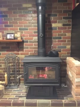

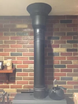

Stove is a Wood pro WS-TS-2000 Wood Stove. 6" flue from stove is about 30 inches. It then is in an offset to adapt to the 8" chimney which if i had to guess was 3 or 4 full lengths and a 12" piece that is used when entering the attic from the stove room. 1 full length of chimney pipe is about the ridge line of the house. This is in the addition of our house, there is only an attic above the room. I attached a picture of the inside setup, I know the clearance is an issue on the one side of the stove (i added some bricks there for now). We are remodeling the kitchen area and that cabinet is coming out.

Nice looking setup. The stove top temps sound just about right. If the full lengths of chimney are 4 ft lengths then there should be enough chimney. Are you able to turn down the air control at least 70% or more once the fire is burning well?

Thanks, I am glad that we replaced the old stove. I feel if i would have seen the old attic setup before i would have never lit a match in the old stove. I was not a good setup. I am not sure the full length of the 8" insulated chimney stack but i am guessing it would be the 3-4 foot range. I have to do some work to it this summer. I saw a couple of things I would like to sure up when i was fixing the old setup. Going to have to be a summer fix though and nothing i feel unsafe about.

Until you get to know the setup better keep an eye on the chimney. Maybe give it a tad more air to boost the stovetop up to 650F. The flue temps are a bit low and going up to 8" is going to cool off the flue gases even more. Clean it after a cord has been burned and see if there is any notable creosote buildup.
