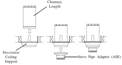

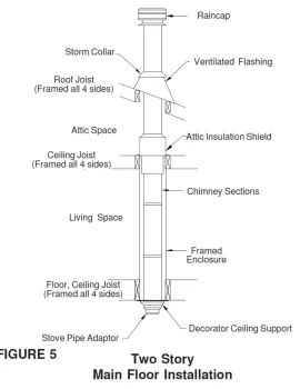

Here is an illustration of a typical install.
[Hearth.com] New but old wood stove install [Hearth.com] New but old wood stove install
