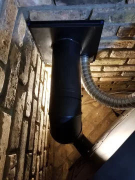

All I can tell you is that I got a thin manual that states Ventis Pellet Vent Install Instructions.

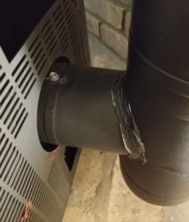

One thing that bugs me is in the photo below. The T is round, but where you see the sheet metal screw, the outside metal of the T has been bent down into more of an oval. I'm no pellet stove piping expert but I would think that should look round there.
But perhaps it doesn't matter if the pipes are sealing internally. It also looks like the installer made a mistake with the screw the first time and moved it back a ways to "pinch" the T to the stove exhaust outlet. If you zoom into the photo, I think you'll see that.

Those T fittings that swivel,yours looks like it does,are notorious for leaking,require lots of silicone.And,you are right about the screw,and the hole.Pull screw out and see how long it is.I have seen so many ruined installations,over the years,from people using long screws,then it pushes in the inner pipe.A long screw can deform a pipe,causing smoke between the two pipes(internal),and it would leak smoke 4 foot up the pipe,at a weak joint.A dab of sealer in the xtra screw hole may fix your problem,but,that part should have been replaced when the installer messed it up.In my opinion,with the new high quality pipe out there,if installed properly,should not need sealer or tape,especially for what it costs.However,others will disagree:).

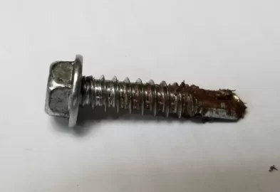

Well the screw is DEFINITELY too long. And it's got red silicone gasket material on the threads. I'm not happy about this "professional" installer doing this. But not sure I want him out again. Could I get by dabbing a bit of high temp silicone sealer on the two holes? I don't see any reason to even need a screw I can't move the pipes anyway.

Yes,fill the holes with sealer,but,they need to come back out and make it proper.The first(wrong) hole has probably separated the inner liner,so,if there is a weak joint further out(upstream),it could still leak smoke.But,yes put some sealer in those holes,any kind of sealer you have.

I did figure out where the smoke is coming from. It's coming from the area between the stove outlet and the T. I was able to shine a bright light in that area when the stove started up and saw the smoke.
Excellent,you diagnosed the problem,which was most likely created by the installer.Best wishes,and stay warm!
