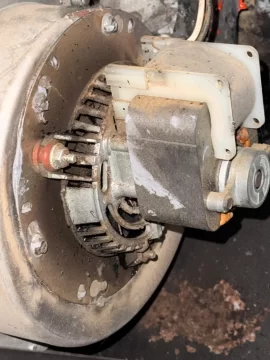

i put a ton of silicone on the adapter im letting it dry not before i start the stove, but i got to noticing the exhaust fan looks like it has some black soot on it. Could it be coming from here? If so do i have to replace the entire fan or can i just replace a gasket?

Just the gasket
as long as the fan and motor are good
and with it off give the fan a good clean as well as the housing
Just the gasket
Yeah everything works great. I just notice the black soot all over the fan. I’m guessing that’s where the smoke is coming from. I put a ton of silicone on the adapter piece and done the door test. So I think this is the only area it could be coming from.
