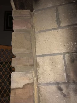

My fire box does have some cracking around the front area where it connects to the house. No other cracks. What can I fill that with? High temp caulk? It goes all the way around you can tell it’s from the house shifting slightly. The rest is good.

Fire box? are you meaning your chimney? if its a masonary chimney theres a little more you have to look for than just seal it up. is the liner cracked? is it pulling away from the home structure? i would have it checked befor you put in a liner and stove..
Sorry I must not be elaborating right. Fire box the box where the firewood goes or where the insert would slide into (I guess that’s not the proper term).
Masonry chimney. Liner is good. Chimney is not pulling away nor falling or any damage to it. It’s in the house.
I can get pics when I get home. That will make more sense.

Sorry for the late reply. Here is what I’m talking about.
