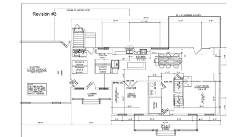

We're at the early stages of designing our house for a total rebuild
Total freedom of design due to fire damage (kitchen stove electrical fire, not related to wood burning)
2500 square foot colonial in southern New Hampshire. Left side of the drawing faces north
I've attached the draftsman's current first floor plan. He has the stove against the stairway wall, in the living room. Haven't though much about furniture or TV placement yet, just trying to get the room layout in order
Do you see any issues with this placement, or better options? There are of course restrictions with placement of the flu coming through second floor, but let's ignore them for now
Looking at a freestanding Blaze King Princess with a double-wall 6" pipe, to replace my Blaze King Princess insert we had in the old house.
Appreciate any thoughts on the plan

The location looks good. A straight-up interior flue system will work well.

Look pretty good to me. Where will the wood come into the house?
I'd consider a wood box or rack on the porch.

Is construction going to be tight enough that an outside air intake is necessary? Planning on an ERV HRV or ventilating dehumidifier? Big kitchen exhaust hood?
If it’s a tight home with little makeup air an outside air kit might necessitate a different stove location.
Good point. It looks like an outside air connection can be made from under the stove to the outside wall under the porch. It's a straight 13' run.
I'm thinking I can store a cord of wood stacked on the front farmer's porch
Previous setup had me storing wood on the rear screen porch but four steps down to grade level were problematic
yes I'm hoping to tighten the house to 2 ACH @ 50 kPa, give or take a little. I'm willing to install a makeup air kit, but then I read this: https://www.woodheat.org/the-outdoor-air-myth-exposed.html

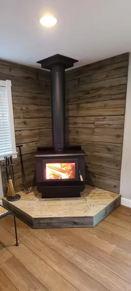

You might consider and elevated hearth. Myself and others have found that it serves two distinct purposes. First, darn as I have aged I like not having to get down on hands and knees to load the stove. (My raised hearth made of 2 x 6's and then 3/4" ply with 1/2" hardibacker with 1/4" stone has made loading much easier on my back & knees.
Second, I was able to conceal the fresh air connection line. When we had a King model with the Parlor legs, you could just see the 3" flex running out the wall behind the stove. This is because the fresh air ducting cannot be run any higher than the bottom of the stove. (Safety measure against reversed draft).
We installed the King 40 with a pedestal this time (Classic) and the fresh air runs down inside between the 2 x 6's and out the wall.
Others have posted pictures of their complete DIY builds of raised hearths. Here is the finished product.

One problem, unless you want a jog in the pipe, is that a straight pipe is hitting the center of the ridge beam. Since you live in NH, you could look into Woodstock stoves - no tax!
yeah I'm going to have the draftsman correct that in the drawings by shifting the stove a bit to the left
