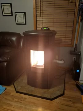

So picked up a 2008 ecotech Elena from a dealer benedicts home and garden in CT that had this left over brand new .
Paid $1200 for it! They said I should be able to file the warranty paperwork as well since there were/are an authorized dealer.
Hooked up the stove last night and boy does it crank out heat. Had thermostats set to 75f and after 12 hours running, room was near 88f!

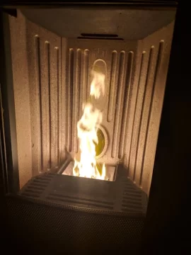

The question I have is it seems to throw a ton of heat at it's lowest setting. I loaded 1 40# bag at 5pm, and at 5am it was nearly empty.
It's running with a temp setting of 75f, and power 1. Flame is consistantly high and hear the fire guard.
Stove said it's modulating, but since I was running it at p1, it never went down and I didn't turn on eco stop.
I do have oak set up, and my exhaust is a tee on the back then 1 foot up, then 90 outside to another tee, then 8 ft up to a 90 with a Hood vent.
So it's not free flowing like a straight pipe, but never had a flow issue with oldstove.
I know there is a password protected menu for fine tuning, but I don't have the password.
Any help/insight would be great.

It doesn't sound like there is anything wrong with your stove. When the room temperature exceeds the thermostat's setpoint, the stove goes to its lowest level ("modulation"), which is "Power" level #1. Since you were running the stove in Power Level #1, you did not see any difference when the stove entered modulation phase. If it is not too cold outside, and/or your house is well insulated, the indoor air temp will continue to climb, as happened to you. Under these conditions it is best to use the EcoStop mode, where the flame goes completely out when the room temp exceeds the thermostat setpoint. When the room cools off, below the setpoint, the stove will re-light. The only downside of the EcoStop mode is that the ignitor gets used more often....which consumes its life. My ignitor on my Elena has lasted since 2012, thru many ignition cycles, so the ignitor life seems to be pretty long on these stoves. A new ignitor is about $60, and it is still a good idea to have a spare on-hand, before you need it. A replacement burn-pot, and the flame-trap baffle are good replacement parts to also have on-hand if you intend to use the stove a long time. Make sure your stove came with the triangular metal plate flame-trap, and that it is installed at the top of the combustion chamber.
