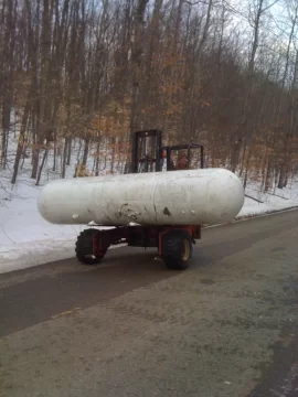

Sorry about all the sideways photos, I will re-format them and repost, trying to get some sorted in a timeline format. That should be interesting
here we go, hopefully this works better...

time to load em up...
  • [Hearth.com] New Effecta Lambda 35kw install with 1000gal storage
and we have arrived!!
