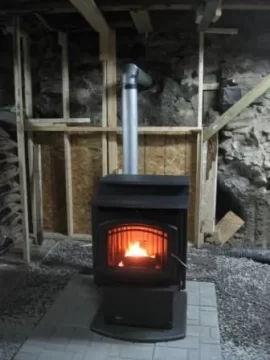

Its finally installed and heating up our unfinished basement (as, I hope, you will see in the attached picture). FYI, we own a 100+ year old house which only had a tiny crawl space that I began digging up in 2005 to a full 8ft deep (7 ft when finished) and underpin the foundation walls. Excavation is now 80% completed, thus the installation of this pellet stove.
I have bought 150 bags of wood pellets made by Granules LG in St-Felicien, Lac St-Jean, Qc, Canada. These pellets seem to be of good quality, I guess I'll have a better opinion next Spring!
So everything works well and we get plenty of heat. I'll let it burn longer tonight as I finished the install quite late last night.
I'll definitely come back later with more details and questions. I have a 30 ft tall SS chimney liner (4in dia) installed and I think I am having a little too much air drawn (flame has the blowtorch characteristics described in the manual)... I'll try to measure vacuum in the stove a little later.

Benski,
Keep us posted on how you like that stove and How the heat output is. I own one of its big sister stoves. Mine has been a pleasure so far.
You should do well with the LG pellet. They have been go for me in the past.
Glad you got it going and Hope it keeps you nice and warm.
jay
Sounds like a lot of work involved to
dig that basement out but the stove sure
looks sweet!
Benski, congrats on the install!
IMO, the flame I see in the pic doesn't look bad at all. Does the M55 have an intake air damper?
In any event, enjoy the heat, and keep us informed on how the new stove runs.
BTW, I agree w/ Jay.....LG granules are good pellets.

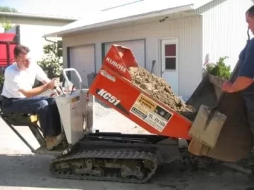

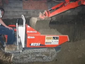

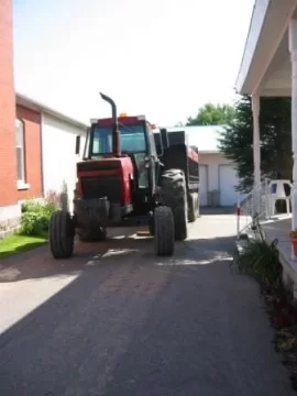

I haven't dug this all by hand... see pictures attached.
The house is something like 54'X28', so I couldn't do this all by hand, no way! I have so far something like 20 dump trailers taken away from the basement and brought back 1 load of clean 3/4" stones for levelling off the bottom of the excavation.
I am glad to have this heat in the basement now. I have only had 2X1000W baseboard heater in there for the last 6 years! I hope to cut my electricity bill in half in the next 12 months... we'll see how I do!

That long horizontal vent run has me worried. Make sure you have a rise in the run
and you will need to clean that out about every 1 ton of pellets
with that long of a run I would have put a T clean out and not an elbo were you made the turn to go out.

Good point. I didn't think about that. When I remove the elbow to clean the chimney, I'll install a T clean-out. That way, I will only have to remove the cap and slide my 2in shopvac tube inside!
