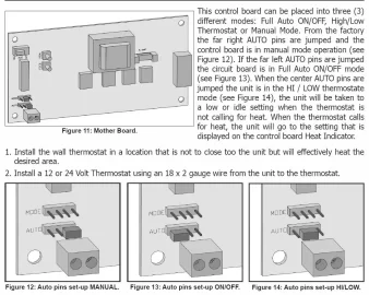

john57 said:
Moderator---Mabey I was feed a line of BS from the installer... All I stated about the TSB is what I was told. Can you answer my question on why my stove will not turn on unless I unplug it from the wall and then plug it back in? There are no electrical problems in my house. Father in law is an electrican
Could be a bad control board.
Do you have the stat option set to MANUAL?
Depending on if your stove is 2007 year control board with the option switch on the front of the control board or if it is the older board with a Jumper you have to move at the back of the control board.
If you do not have a Thermostat this with make the same thing happen.
with the board set on ON and OFF thermostat mode you can not turn the stove on from the control board.
but with the boards build in POWER RESTORED auto restart feature when you loose power (unplugging) and power is restored the stove will automatically start back up.
there is a 3-10 second delay from the time you plug in the power and the stove will start up.
this is a tell tell sign the Jumper or stat is set to ON AND OFF stat.
I found this out Tuesday when I when to a customers house that has a WINDSOR (older version of the Empress)
he WILL ONLY USE IS STOVE IN ON AND OFF THERMOSTAT MODE.
he said his stove worked fine but it would not shut off with the WIRELESS thermostat.
Turned out that He had NEVER changed his batteries in his REMOTE thermostat RECEIVER connected to the stove
He only change the battieries in the HAND HELD.
anyway when I was playing with his stove trying to figure out what was going on
I noticed that when you unplug the stove and then plug it back in it would start up automatically even if the thermostat was not callling for heat.
is this a free standing or fireplace INSERT ??
Never mind I see in your first post that this is an insert
There is a jumper setting on the MOUTHER BOARD that is mounted behind the panel in the stove
they might not have the thermo stat Setting set to MANUAL
here is the jumper settings on page 10 on your TECH manual.
  • [Hearth.com] new envrio empress problems
Moderator---I had it installed by the dealer...I do not know how he has the stat option set. I assume this is a 2008 model, (it was installed in september-08) Its funny, my brother has the same exact stove, (installed this month) and uses the same exact pellets and has none of the problems that I have.
