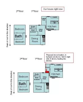

The place where we are talking about putting the alcove is in the wall right next to the kitchen entrance (look at the attached diagram). Behind this wall is a covered porch that we are about to have remodeled. We were thinking that we could take over some of the porch to hold the alcove for our stove. Because of this, I do not think it is a very big job to do: the roof and floor are already in- we are just moving the back wall backwards by three or four feet.
Our kitchen was remodeled and enlarged last year, and now it is quite cold in the winter. We thought that if we located the stove where we are talking about putting it, we could put a vent in the right wall of the alcove, feeding directly into the kitchen (using a fan to blow warm air in).
We cannott think of any other place in the house where we could put a wood stove. It would be possible to put it right into the kitchen, but then we would have to hang out in the kitchen to watch the flames. The living room is much better suited for that. Upstairs is already too warm in the winter, and so a stove isn't a good idea up there.
In addition to the stove, we wanted to put in some kind of door into the back of the alcove, so we could feed wood in that is sitting in our porch during the winter.
I have looked at the published stove-wall clearances, and it seems like we really would need an alcove of at least 3 or 4 feet deep, by 6 or 7 feet wide, just to meet those requirements. That doesn’t leave much room in the left side of the alcove for stacking wood.
We are looking at stoves in the 30-40 kBTU range: Jotul, Dutch West, VT Castings, Hearthstone, Morso. They pretty much all have the same clearances, give or take.
I spoke to people at two fireplace stores today, and I got some rough numbers to have the stove bought and installed in an alcove that we will build. The stoves are in the $1500 range, the stove pipe (20 feet high) is around $1200, and installation is $500 or more. So we are looking at around $5000 to install a wood stove in our house, including the carpentry work to make the space for it. That seems like a lot of money to me, and I'm starting to rethink the whole project.
Do people have a different opinion or take on what we are trying to do? I feel like I am in a hurry to make a decision. Our contractor is coming back in a couple of days to work on our house and our porch, and it occurs to me that we should know how a wood stove would fit into one part of that space.
I have attached a diagram of our house floor plan, to see if anyone has any other ideas. The living room is 13x15 feet, the Kitchen is about 18x19 feet; (with a 16 foot; high cathedral ceiling).

Well looking at your layout, I tend to agree with your placement idea, despite my earlier comments about the idea of alcoves and outside chimneys in general, it looks like your best choice. I would probably not try to put a door to the outside in the alcove, however I would open up the wall between the kitchen and the alcove as much as possible, not just put in a vent (BTW, I'm not sure if a vent would be OK code wise...) I would then use the existing door into the kitchen to bring wood in from the porch and just haul it around the corner. Opening up one side of the alcove might also help with some of the clearance issues, as would making the alcove ceiling as high as possible.
I would bring the chimney out the roof of the alcove into a chase, preferably insulated, that would bring the top of the chimney up above the peak of the roof (per the 10-3-2 rule) You might need a couple of bends to get the chimney pipe where it needs to be, keep them gentle, 45* max is best...
In terms of the carpentry, I'd agree that bumping the walls out may not be a big problem, however you will need to look very closely at how you handle the insulation of both the existing ceiling and floor parts, and also how you will turn the existing porch floor into a sufficiently non-combustible hearth to meet the installation requirements....
Further examination of the stove options may also find stoves with lower clearance requirements, especially look for "convection" style stoves as opposed to "radiant" style. Convection stoves use multiple walls and an air jacket to circulate hot air (some with a blower) rather than simply radiating heat. I know you said earlier that you'd like to avoid blowers, but the big advantage of a convection stove is that they can sometimes offer GREATLY reduced clearances.
BTW, There has been some discussion and debate about clearances and stored wood. Code is quite clear about how far stored firewood should be from the stove, but there are some folks who argue that the number is unrealistically high - it appears the assumption is that the stored firewood is going to be left sitting for extended periods while the stove is burning, allowing some of the carbonization reactions that make wall clearances an issue to take place, lowering the ignition temperature into the danger zone... Some here (including myself) feel that as long as you are always "rotating the stock" so that nothing sits next to the stove for more than a day or so, it is possible to "crowd" the clearances a bit. I certainly would only consider this on temporarily stored things like the wood stack (in a non-combustible rack) and never advocate crowding a clearance on a permanent fixture like a wall, etc.
Another thing that some folks have done is to build various types of cabinets w/ heat shielding next to the stove to store firewood in, others have built very tall raised hearths with wood storage areas under them... Both might be doable in your application.

This is a somewhat sprawling layout, one I might consider two stoves for. If the stove is just to heat the kitchen area, then a local heater on the porch, without alcove should work. If an alcove to the living room, the way it is diagrammed with a vent to the kitchen, there will still need to be an active circulation device (aka electric fan) to share heat into the kitchen (assuming the alcove opens into the living room).
I am assuming that you are converting the open porch to an insulated and totally enclosed porch. Is this correct? If yes, perhaps consider not putting in an alcove but instead just a generous opening in the living room that connects to the kitchen via the porch. That will allow better heat circulation for a freestanding stove in the porch area and will let in light to the living room and will be less expensive to build.
Well we asked for more info and you provided. The location looks great to me, and like Gooserider I think an alcove would be a nice way to add a freestanding stove without impacting the room.
It looks to me like you have a large enough opening between the LR and Kitchen that you won't need to add duct work to transfer the heat between the 2 rooms. IMO natural convection will do the job. Ideally your stair case would drop into your LR, but it's just in the next room with is still nice.
The only other thing I'd consider is that you'll be hauling wood from outside through the kitchen and into the LR. The wife will especially note any mud, saw dust, and over-all debris trailed into the house.
Either way it looks like a great central location.

Well one thing to keep in mind too, If I read the post right and the diagram you have a 16' ceiling in the kitchen and a big window seat... The heat you try to (or have going in there now) is only going to go one direction.........up.
