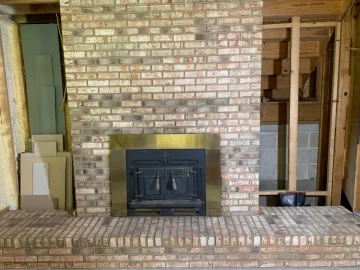

Installed a few months ago. They say the glass should stay clean but it always gets covered in soot. I have been using some store bought bundles as my oak will not be seasoned till after March. Im getting better but it always seems to take 30 min or so before the blower kicks in. I noticed the putty they used at the pipe joint was starting to flake as well. The company who installed it also chipped my brick removing the old insert. Overall I love the new look though.

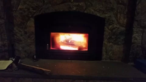

I don't have a cat probe, so i start to close it while top temp goes over 500f. This is my DYI probe.

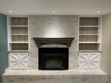

I have the same insert as well. You're install came out great. Much better than the "before" pics. Nice job. The insert takes a little getting used to. My only issue with it is that it can be a little rough on catalysts. Either that or I am. I wish there was something that blocks the flame from touching the cat. There is a thread on this page where Dmitry shows a pic of a shield that he came up with the limit the flame contact with the cat. I am considering this as well. Given the opportunity, I would still buy the same insert.

Clydesdale thats for the input I put a lot of work into remodeling this room recently. You cant tell but I did not have drywall on the ceiling in the before picture either or the spot lights. My baseball coach from years ago custom made the built ins and we just installed them last Saturday.
