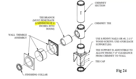

A stovepipe (either single or double-wall) can not pass through a wall or ceiling. It is only for use in the room that the stove is in. Class A chimney pipe must be used through the wall with an appropriate pass-through wall thimble for that chimney pipe. This connects to a class A chimney tee and then it is chimney pipe only all the way up.

If you are going through a wall you need a wall thimble, then transition to class a chimney outside. Any reason not to go straight up through the roof?
Hi, so you don’t want singlewall pipe touching the wood. Ever.
What kind of chimney are you attaching to?
If you have a masonry chimney outside you can use an insulated thimble like this.
