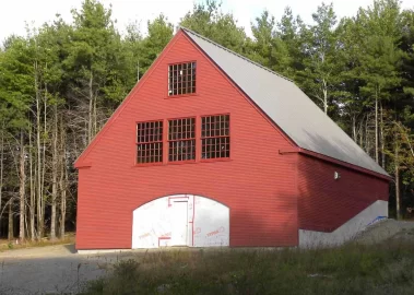

Please tell me that will work so I can call and cancel the sale of the roulette table. Here's a pic of the build so you can see why I'm trying so hard to avoid those 12' stacks.

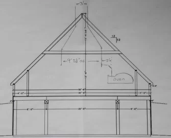

Depending on clearances, ceiling height and the pipe used, some of the offset could happen on the stove floor. Keep in mind the cleaning of this system and the affect on draft. Can you post a simple diagram of the planned runs?
Here's a quick sketch of what I have in mind. I'm hoping that I can get the extra 2 feet where the oven plugs into the flue at the bottom where the cleanout tee would be. It's not to scale and the attic floor is shown 2 feet above where it is. The ceiling height on the oven floor is 10 feet, the ceiling height on the attic floor I think is 12' 6".

That may work, though not sure about the pizza oven's requirements. I'm not sure if it will like the extra 90 in the cleanout tee. If that's a problem it may draft better with just a pair of 45s with a connector. Is there a manual for the oven that defines flue requirements?

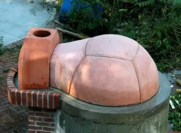

Thanks Begreen, I really appreciate the help I'm getting here. I found the manual for the oven. Sadly it's written in Italian. I can go to the Forno Bravo site and get the flue requirements for the oven. Would be nice to have a cleanout tee at the bottom. It would be real convenient for doing just that. But if it will draft better with some elbows is there another way to get in to clean/inspect it? Is it mandatory that the pipe connecting the stove/oven be exposed on the main floor? Where the stove pipe connects to the oven is actually behind the face wall where the opening to the oven is. I'll post a pic so you can see what I mean. I know the oven looks real heavy. Just the top part is coming inside sitting on lots of steel. On the other side the stove is a Hitzer 354 but will eventually be replaced with an old wood range. I have some floor protection questions regarding these wood ranges. I'll ask about this later.
Other Flues are going up through that same faux chimney also. These stoves will be going on the top floor where the space will be divided into two sections. A bedroom and a small kitchen. I found an old gas parlor heater and a gas kitchen range I'd like install in the attic to keep the decor as "turn of the century". I would love to get some feedback as to what type of flues might these relics be needing. I'll post a pic of the parlor stove along with the pic already posted under "Old Stove" in the "It's a Gas" forum. Thanks again for all the help!
