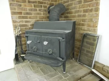

Hi Coaly, My wife and I recently bought a home (rancher) that was built in the mid 70's in northern Maryland.
Upstairs is a Fisher Insert & and downstairs in the basement is the Grandpa Bear (from what I can tell from this forum, I'm pretty sure it is a grandpa).. We've had several chimney companies come out to the house to inspect our chimneys and give estimates for repairs. (3 flues total, both Fishers, and also the furnace flue).
All existing flues are clay tile and show signs of wear (the plan is to have them all replaced with modern stainless liners).
Question 1: All the chimney companies agreed that the Fisher insert (which they all called a "slammer") needed to be removed (for safety reasons) and replaced with a modern insert in combination with a 6-inch stainless liner. I've read about "slammers" on the internet and there does seem to be a safety concern out there that is consistent with what the chimney companies were saying. So my question is, are "slammers" dangerous, and should I replace the Fisher insert.. It seems a shame because it is a cool piece.. I thought I would ask you (who seems to be a Fisher expert) if you had any thoughts on the "slammer" matter.
Question 2: The downstairs Grandpa Bear is connected to 7inch square clay tile chimney flue. 2 out of 3 chimney companies said that the existing flue was fine. All three companies want to replace the black stove pipe from stove to wall (this makes sense as it is a bit rusty).. 1 out of 3 companies (and the one we like the best) wants to break up and remove the clay tile flue and replace with a 8inch stainless steel modern liner and then connect the grandpa bear. I've been getting some pressure from outside opinions to replace the "old" fisher (grandpa) with a more efficient/modern woodstove with a 6inch outlet/liner (avoiding breaking out the current 7inch tile). I've read on some of your posts about the baffling trick to add some efficiency. I may inquire more about that later. Right now I'm planning on keeping the grandpa bear and letting the chimney company reline the chimney with a 8inch liner and replace the black stove pipe and light a fire. I really like the stove and just want to use it. It seems as though there is a high regard to Fisher Stoves and I think it would be a shame to take out the grandpa bear. Any thoughts on this Coaly?? Does the plan make sense for the 8 inch liner?
Anyway, Thanks for thoughts and opinions in advance. I'm very new to all of this.
Tom.
-I've uploaded some photos of my stoves so you can see what I have. (hopefully the photos work).

Welcome to the Forum;
The Insert was designed before liners existed and was UL approved when installed as shown in the manual. With the use of a "boot" to connect to a liner it will connect the same as any new insert. The main factor is not installing into a hearth with a huge flue that was the norm for a fireplace. You simply don't allow enough heat up a larger area than the stove outlet to keep it clean. A few advantages are not removing the Insert every time you sweep the chimney, and all the air will go through the Insert instead of around it if there are any leaks at the face plate seal. Any air that leaks around the faceplate rushes up the chimney cooling it, and prevents the needed oxygen from going through the Insert. So there are definite advantages. Local codes are going to vary as per installation, but normally when an appliance was installed up to code at the time, and was UL approved, as long as it remains unchanged, it is still approved. UL listings don't expire as far as I know. The problem with the installation is that it can become unsafe if the faceplate leaks or is used incorrectly. By all means, every one of these Inserts should be connected to a liner with what we know today about the history of problems with the installation.
It is a Grandpa. I wouldn't invest in an 8 inch liner since most any newer stove is going to require 6 inch. Codes do not allow the reduction of pipe or flue smaller than the stove outlet. The problem is, that code was written to prevent anyone from choking off a stove since the outlet was normally sized to the square inch of the firebox. The firebox size of the Papa Bear is just as large as your Grandpa and was built with a 6 inch flue. So If you want a Fisher, That's the stove I'd recommend connected to a 6 inch liner that could be used with a newer stove in the future. You lose the ability to view the fire, but gain a whole lot more.
That said, your stove will physically work fine connected to a 6 inch liner. The reason for the larger 8 inch outlet is due to open door burning with spark screen in place. Many are in use reduced down as well as Inserts reduced to 6. A quick search of Craigslist will show many for sale with 8 to 6 reducers, and a few members here have added baffles with both stoves and Inserts reduced with no problems. Not saying it's legal to do so, but they physically work with no smoke roll in problems with a good chimney. Like an engine with a restricted exhaust or intake, you're limiting output and won't get full throttle, but that much heat is rarely needed. Another plus is the faster velocity in a smaller flue decreases dwell time. The larger the flue, the slower the movement and the longer the smoke particles have to cool and stick.

Ha! If i had known that, I would of taken a better picture. Obviously the insert isn't being used right now due to the instilled fear and the fact that it is not connected to a liner. Unfortunately the insert may have to go... I think the ultimate goal is to Veneer over the brick, add new hearth stone, and install a more modern/efficient insert (with blowers) and do a 6 inch liner all the way up..(this will be a big project, I know)... My wife would prefer something more flush anyway... we'll see. It's good to know the option with "the boot" exists to attach a liner... Like I said we are trying to figure it all out. The house is still pretty new to us.
For the Wood Stove in the basement (Grandpa): As I am not qualified to do any liner installation work or pipe reduction work, this will have to be hired out. and as you say, I may have a hard time finding a company that will reduce the pipe size due to legal reasons. I also don't plan on replacing the Grandpa anytime soon, in fact I would hate to see it ever leave. I don't see a way around installing a 8 inch liner for it though. I want to use it and for a long time. I understand what you are saying and in theory I would be ok with reducing from 8 to 6... but like I said I'm not sure I could find a company that would do it... Would a 8 inch liner be the end of the world? Would adding a baffle help a little?? Hypothetically if we did get a new wood stove YEARS down the road, what would it mean to run a 6 inch stove pipe into a 8 inch chimney liner? ..But like I said, I think we'll get many years of use with the Grandpa...Why not install a 8 inch liner now and run "Full Throttle"??

I assume the brick wall next to Grandpa is solid non combustible and not in contact with any combustible material?

7 inch works fine and you won't have any smoke roll in unless the larger chimney flue isn't warm. That would happen even with 8 inch all the way. Yes, code doesn't allow reducing. The size of the firebox is no larger than a Papa Bear with 6 inch outlet, but since yours was made for fire viewing with doors open and a screen in place, the outlet was made larger. Even people who have added baffles with reduced flues don't have smoke roll in problems with a good chimney. (Maybe yours is the more common 7 X 7) ?
If there is any single wall at the adapter closer than the 18 inch clearance, simply make a heat shield above it with at least 24 gauge sheet metal or piece of single wall pipe with at least 1 inch clearance between pipe or ceiling. There are commercially made ones as well as seen near the bottom of this page;
(broken link removed to http://www.rockfordchimneysupply.com/singlewallblack.php) Just like with double wall pipe, the clearance is reduced to 6. Some people just don't like the looks of a shield, but they don't have to look like a piece of tin from 1880 above the pipe ..........
You could have saved the expense of the double wall pipe, and possibly over crimp the 8 inch end into the thimble with hand crimpers? They shrink the crimped end down much smaller than a factory crimp.
The risk of chimney fire is greater with a flue larger than the outlet on the stove. The larger the inside diameter, the more heat required to keep it hot enough to draft properly and not condense inside causing fast creosote build up. Plus, the larger the flue, the slower the rising particles, increasing the time they are in the flue allowing time to cool and condense sticking to the sides.
