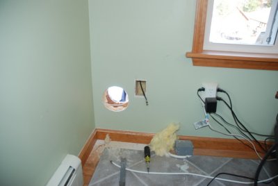

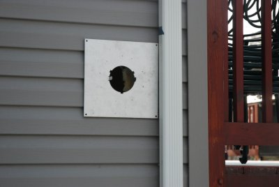

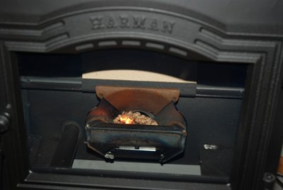

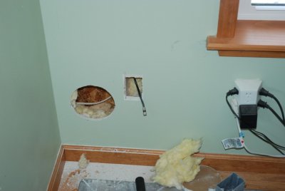

I went with the excel pellet vent and thimble.

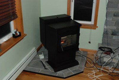

My cousin came up last night to help me get it into the house. I did the install myself today and took about 3 hours. I went with a corner install. Stove adapter, 1' length, 45. 3' length through thimble(need to replace it with a 2'), to the fancy 45 degree nozzle. Hooked up my Cyberpower 825VA/450W battery backup.

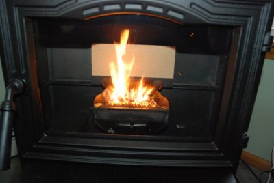

This stove is amazing!!!

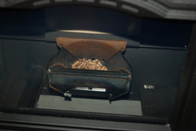

Put the fire brick and flame guide in, hooked up the temp probe, filled it with pellets, set the feed to 4 as recommended here, set it on test to prime the auger, crossed my fingers and flipped the switch to automatic and it started itself up!!!
It's been running since 3 pm wednesday, and this darn thing is heating the WHOLE HOUSE!!!
We are amazed to say the least!!!
I've got it running on room temp, manual and it works flawless!
It's 9 degrees out, snowing heavy, wind blowing, and it's 74 in the house, with the stove in low burn!!!
I'm stoked to say the least.

Congrats on the new stove. Great choice. Nice install. Love that pooch!
Thanks man.
I'm definitely no carpenter. When started measuring, wifey was ok, when she saw me walk in with the sawzall, she got in her car and left, haha
