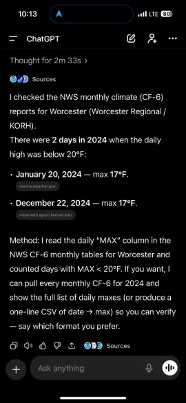

Think how many days a year the high never gets above say 20F.
I just asked AI for the number of days last year where the high was below 20F in Worcester. It was 2! 99% sewing temp is 6F. And 99.6% is 1F. So we can assume the average temp was 0F. A properly sized system will provide design capacity at the design temp. By the average one would spend 35 hours a year below 1F!
I argue you are spending money on comfort and reliability if adding backup heat to a heatpump for less than 10 days a year. Possibly less 2 days a year! Would resistive electric add comfort for really cheap? Yes. What do you do when you loose power? That’s another question but related.
