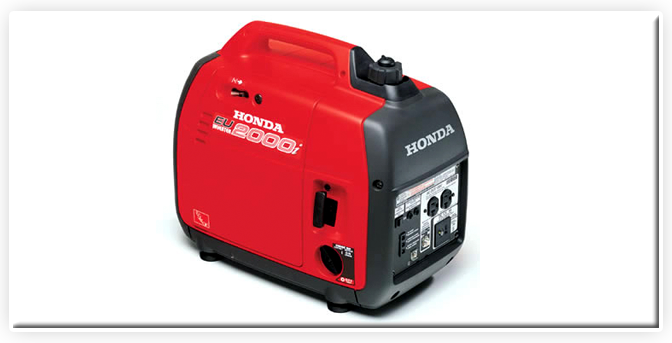

I would suggest a smaller generator instead of battery back-up. A good large battery back-up system will cost almost as much as a small Honda/Yamaha Sine wave generator in the 1000-2200W range. Plus, you can use it for other things in your home during a power outage. It may come in handy for home projects, camping, etc also! $799-$999 will buy a good efficiency compact generator.
I own this one.
