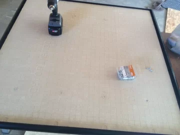

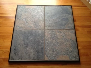

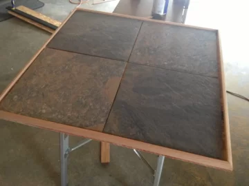

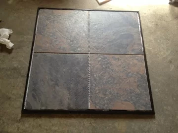

Hey Everyone,
I'm new to the forum but I've been lurking for a couple months now. Anyway just thought I'd introduce myself, share my DIY stove pad and get some feedback. As for the Harman P43 I'll be doing a self install with selkirk out at up 4 feet vent. Any install tips would be appreciated. An OAK is part of the plan but I have not purchased one yet. Any recommendations?
Thanks.

Pad looks good. If you put a piece of loop carpet upside down under it you should be able to move the stove around easily for when you want to service without being a contortionist.
Thanks, I ended up putting those small 1 inch or so felt pads about every 6 inches under the pad, its fairly easy to move now but I'm not so sure how easy it will be with the stove on it.

Materials List for Stove Pad:
1/2in OSB for the base
3/4" Oak quarter round for the trim
18" Tiles from Lowes "Aspen Sunset"
1/4" HardiBacker board
1/2" screws for attaching the HardiBacker to the OSB
Universal Tile Adhesive 1Gal
Gray Grout
Felt Pads for under base
Black Rustoleum Paint
