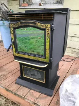

Hello everyone. Brand new user to this forum. i have read a few threads on recent stoves i have owned and this forum has always been helpful to me with my Whitefield Advantage 2 insert. Upgrading to a P68 Harman that i got for a steal and the original owner states that he put in a new igniter but he says when he gets through burning a pot of pellets the unit powers off and he has to unplug it for a few minutes and it will work again. Any Harman owners experience this before?
Attached are a couple pictures of the unit. cant wait to get it hooked up and running! =)

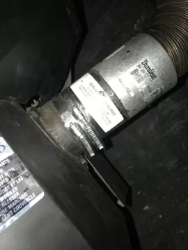

Wait, you hooked flex pipe directly to the exhaust?
These are the 2 pieces harman and duravent told me to get in order to make it work with flex pipe but I need a bigger stronger band because it doesn’t stay on well even with 2 of the stealer style straps
duravent harman adapter- 3pvp-adhb
Duravent flex pipe adapter- 3pvp-adff
bought them both from coastal farm and supply they had them in stock. Here’s what it looks like. But like I said the harman adapter with 2 clamps on it still will fall of if pulled with little force..
  • [Hearth.com] New Harman P68 Owner
Drill a hole on each side through the appliance adapter and the tailpipe, dab it with some high temp silicone then zip two self tapping screws into it.
I use some real short self tapping 5/16s but if you predrill you could probably use 1/4. You just want them long enough to hold it but not so long that they catch your brush when you brush your pipe. Bye, make sure you pull your esp before you brush your exhaust if your brushing it from the ash pan area which is what I do.
Could also use a bottle washer.,( soft brislle brush with long handle) on the esp and not remove it. Many here do just that. Works fine.
Reactions: bags
Usually the esp has soft powdery ash on it so a few gentle back and forths with the brush removes it.
If you brush the pipe from the front with the esp still in it you will likely snap it off. I pull esps to clean them and they always look brand new when I’m done. Will they work if you just brush them off? Probably, but I get paid to clean them so I get them clean.

I understand. I think you misunderstood me, as I was pertaining to gently brushing the ESP only. I use a flat vacuum extension to get the ash out of the pipe. Yes it would probably break if you vigorously brush that tunnel out with a brush. I do pull it once a year and wipe it down with alcohol to where it's nice and shiny again.
