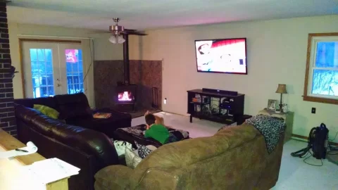

So I thought the stove and hearth and chimney being in the middle of everything would be great. Wrong! After 6 months of stubbed toes and living room being arranged funny and stove blower only blowing into the livingroom I finally got fed up...
So. I decided I wanted it in the corner. So after researching and talking to retired stove installers at work I got working.

So. Here we are. Just got done tiling the walls. First time tiling. Just got the hang of it. Grout tomorrow night. Beer time.

Once grout is done stove will move over and new chimney will be installed. Double wall up to duravent through the roof kit. Then class A 9 feet up.
Bummer about the wall tear down. What stove is going in and why the NFPA wall shield? In the future if you do this again, you can create furring strips by snapping off 3" x 36" strips of the cement board and doubling them up.
A diamond shaped edge on the floor may have made for less toe jamming on the corner
