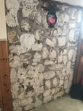

Thanks Begreen. I appreciate the reply. The rest of the walls are insulated so I think I’ll be alright. I removed the existing book stonework from the prior owner from the block wall behind the stove and I’m planning to restone it with veneer. When inchiseled off the old stone there’s a layer of some sort of mortar or adhesive left on the block. It’s pretty thick on some spots. Should I try to remove as much as I can with a chisel or do you think I can scratch coat right over it?
  • [Hearth.com] New Hearth for Wood Stove
Might have used construction adhesive. That stuff can be tough to remove. Some bond exceptionally well.
Wire wheel on a grinder may take off the residue. Kind of messy! Just a thought.
