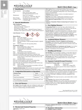

If I were you, I'd ask the mfg for the msds (that should hopefully give you a clear case that this is not a fire hazard) - and file that with your insurance papers.

Does this help? [Hearth.com] New hearth[Hearth.com] New hearth
StoneCast makes it clear that thick resin will outgas and recommends heat (in an oven) to help reduce outgassing. The heat from the stove may do the same.
