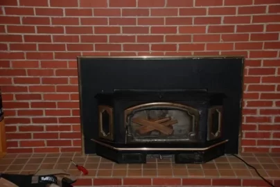

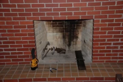

well got it installed and it's a whole lot easier to use that I thought it would be. I even woke up this AM to find hot coals so I just tossed in some new wood and off it went. In short- I love this thing. Lots of heat, easy to use, no smoke smell in the house now. Here are a few pics. Now- is it normal for me to just want to sit and stare at that fire?

Congrats! Yes, it's normal to want to sit there in a trance while watching it burn. Did you go with a full liner install or slam that sucker? It looks really nice.
