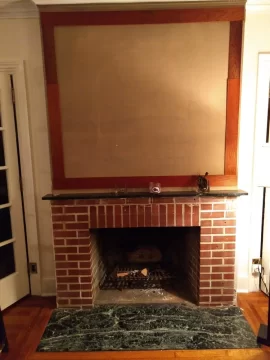

Looks great , I guess at this point I'm down to a BK ( wife loves the Ashford) or the PE summit. Decisions , decisions. *Edit* Just noticed on the BK there is no way I could do a free standing stove
![[Hearth.com] New here with a few questions [Hearth.com] New here with a few questions](https://www.hearth.com/talk/data/attachments/216/216024-ca838ffb0c3a15b1d4e38f39f91c7648.jpg?hash=JXcZ8Vf1_H)
