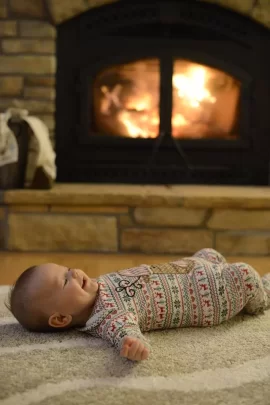

here's an example of my ZC fireplace. FYI: to be clear, it's not ZC + insert. the insert is what you'd get if you already had a fireplace there and were just cramming something inside of it.
[Hearth.com] New Home - 1st Stove - Endless questions.... [Hearth.com] New Home - 1st Stove - Endless questions....
Reactions: Ashful
