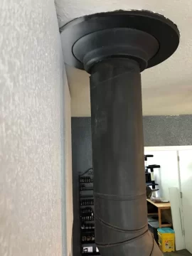

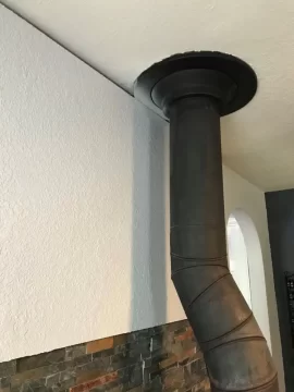

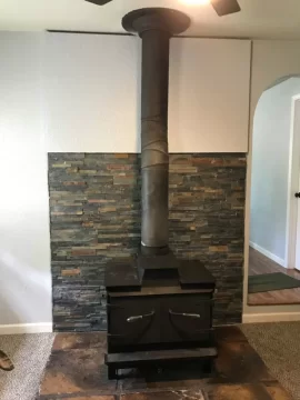

We have a 1978 wood stove that I had cleaned today. The company that came to clean it said it should not of passed inspection. it said that the the pipe needed to be 9 inches away from the wall. Which it is not on top. i will post photos to this post. They quoted me to get a whole new stove with a 6 double wall pipe. I asked if that was needed (a whole stove replacement) and they said yes but did not elaborate.
Do I need a whole new stove? thoughts on this placement? Its the only source of heat in this moderately sized bonus room.

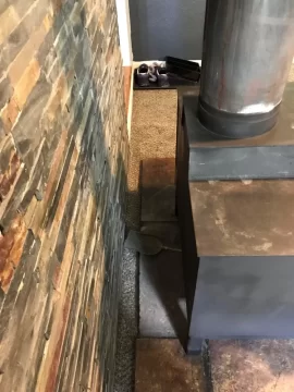

That pipe does look too close to that wall.If you want to keep as is run insulated pipe from stove to ceiling which only needs 2" clearance to combustibles.I'd put a heat shield behind the stove and more floor protection for that rug which seems to run around and maybe under the stove.

Removing an uncertified wood stove in WA state is not required when you are buying or selling a house. However, the sweep was correct, that does look like a poorly placed ceiling chimney support. The closest a stove pipe can be to the wall is 6", but only with double-wall stove pipe or shielding on single-wall stove pipe. If the rear of the hearth is just a fake stone veneer then there is also a good likelihood that the wall behind the stove does not qualify for any clearance reduction for the stove and that the stove is too close to the wall. Is there a UL label on the back of the stove listing the rear clearance requirement? If there is none, the clearance requirement is 36".
It's hard to tell but it looks like some sort of attempt was made to change the material above the hearth, behind the stove pipe. It looks like a raised panel with texturized paint. What is that made of?

The label on the back of the stove says (which I had no idea was there!), "16 inches out from front, 8 from sides and 12 from rear" interesting.

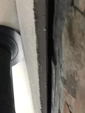

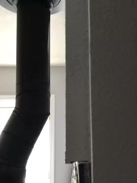

You are right it jets out above behind from the wall about an additional 2 inches. Its drywall of some sort (unsure of type or kind) studs and then it vents? or is open at the top and bottom and not fully closed, see photo. We assume this is for a venting of heat?!?!? the bottom is a stone material, just shy of an inch thick, over drywall/wall. Thoughts?

Looks like someone made an attempt at a wall shield, but who knows what they used. If it is cement board then it might be ok, but if it is paper coated drywall, then it is not.
