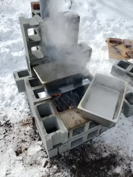

Looking at the weather here this coming week we may have an early sap run so I got my taps in today. I'm pretty small time, we only have 20 taps total, but its a lot of fun with the kids. My 5 year old had a blast tapping the trees today.
I put together my MacGyver evaporator today too. Tried a few new modifications but for the most part it's just standard 16x8x8 cinder blocks, pavers for the firebox floor, a 5' section of 6" pipe, and a piece of thin sheet metal.
The pipe and sheet metal are new this year in an attempt to get the smoke further away from the sap. The stack is shaped into the cinder block and there's a 6" gap in the blocks all the way to the floor. My hope is it'll draw air from the front opening and the sheet metal will act somewhat like a baffle and cook top and the smoke will exit up up stack. Im thinking I may have to seal the little gaps between the pipe and block where I stuffed it in but we'll see how it goes.
That's the plan anyways! I'm open to any suggestions or criticism...I'm new at this! !!!

Do the blocks work? I would think they would crack from the heat. I hope it works well for you, we have a handful of sugar maples I'd like to tap in the future, certainly not enough for a serious business evaporator.
This is about as high tech as im willing to go right now lol. Some of the blocks will likely crack but they will still function this year and only cost $2 each so its no big deal. I'll toss any cracked ones and save the rest for next year.
This is the plan anyways!

Can go to Lowe's and get firebrick for the floor and one layer around which might protect some. Saw pallets of them in the construction material aisle, and they're cheap enough.
I thought about fire bricks but I think the regular pavers should work fine, also cheaper. I'm debating making it one level lower overall actually. Being 3 cinder blocks high the firebox is awfully big. Im gonna mess with it tomorrow and see how it looks 2 blocks high.

Did a test boil today just filling the pans with snow. Went well! Excited for the run.
[Hearth.com] New Homemade Evaporator[Hearth.com] New Homemade Evaporator[Hearth.com] New Homemade Evaporator
Now buy a few metal fence posts and some angle iron and make frame above the bottom trays put two more trays above the bottom ones. Tilt the trays to one side slightly and add a gutter under the drip point so that if anything condenses on the bottom of the top pans, its flows to the edge and then into the gutter and onto the ground. This preheats the sap in the upper pans above the primary pans which increases the efficiency. I think pro rigs will even use a third stage set of pans.
That's a good idea but a little more work than I want to bite off this season. This needs to be a temporary structure I can take apart and store easily or repurpose. I could make that work...I'll add it to my list of possible improvements for next year!
I am going to make one modification next boil though. I'm going to extend the firebox another 8 inches. I'll just use 2 vertical cinder blocks and add a few more bricks on the ground inside the box. I'll cut a piece of sheet metal to cover the 8 inch gap it'll create on top.
As it stands right now the pan next to the chimney boils nicely but the far pan only warms because it's too close to end of the box/air intake. The chimney drafts pretty well and is sucking all the flames onto that first pan. By extending the box I'll be able to get more heat onto that pan and have two pans boiling at once. I'll grab a 3rd pan or maybe even a disposable foil one to put on that 8 inch metal covered gap to use as a warming pan. It'll chew through more wood but it should greatly increase my efficiency.
