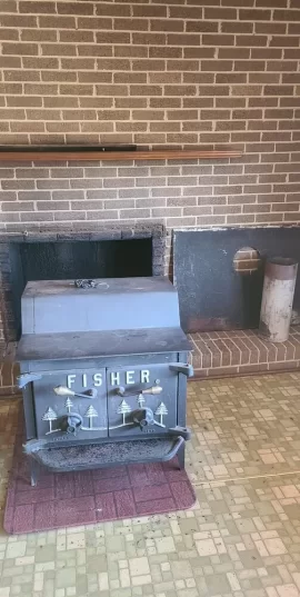

Just bought a new house that has an old free standing stove that was piped through a block off plate. When looking at the house I wasn't permitted to remove the plate to inspect. I think that was more on the selling realtor than the 92 year old lady that sold it to us. Anyway, after removing the plate, I find about 3 inches of creosote buildup at the bottom, and lots everywhere else.
The issue is, the chimney is 19" deep at the bottom, 15" at the top of the opening, but it appears there is a fixed plate for the damper that leaves about a 4" opening to the smoke shelf. Say I could manage cutting it, the flue is separated into two (what appears to be) 4"x6" flues. How do I go about piping my buck model 74? My wife wanted to bring it instead of buying a new stove. Side note, I swear I don't remember that stove being that awful to move around 10 years ago, lol. Thanks for any input.

Here's the stove I'm giving away. Kinda wish I was charging for it after getting it out of the house. I swear it felt like it weighed 500 pounds. 3 of us, 2 makeshift wheel dollies, an 8x8 a few 4x4s and about an hour later, it's sitting on the front porch. For the life of me I could not figure out how to get the fire brick out. There was a steel tab holding each piece in place.
