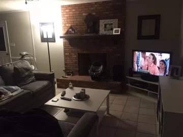

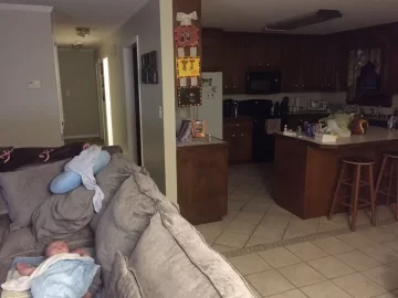

hey guys. I bought my house end of last winter.
Well this winter is coming up and I hate wasting needless energy on my old heat pump. I heated all last winter in my other home with wood. I love cutting and splitting and burning wood.
Well I have a family now and a son and I work a lot and will be starting law enforcement training this winter, so I won't be home much.
My plan has been a wood insert but I'm afraid my wife can't keep it stoked well enough while I'm away. I've thought about pellet stoves as well.
With this house lay out, single level ranch, should I get a wood insert or pellet? Input is helpful. Thank you.

Do you have dry wood to burn?
How about a Free Standing pellet stove so you can still burn wood in the fireplace?
that is a good idea. Although I don't have a place to vent it, and I was wondering since my house is very open to itself, an wood insert should heat very well, correct?
First thing come to mind would be bk princess insert. I think it will be the easiest insert to operate and will offer the longest burns. But there is other things to consider, dry wood is a must, how big is the house, insulation windows etc. would princess fit in your fireplace, how tall is your chimney, what's your budget? There is a lot things to think before you decide what to do.
It would be helpful to know what the chimney is like. How long? Liner? etc..
Sq footage of the house?
Also, what your budget would be?
Just looking at that I'd be leaning toward a freestanding wood stove in there personally.
Nice tile floor BTW.
Don't put wood burner yet. Start cutting and splitting wood a little at a time and get your studies done. Put a wood-burner in in a year or three.

Dustin, you have received some good options. Replacing the heat pump with a modern high-efficiency unit that heats and cools well will serve you year round. An insert will heat well, but get one that sticks out a bit on the hearth if you want to have heat with the blower off. A pellet stove bring greater convenience and ease of use, but it will need blowers running all the time and will be higher maintenance.

Ok how is about 1600 sqft my chimney is approx 13 tall, it has a clay liner approx 12x12. Insulation is about 10" in attic, the crawl has insulation underneath. My windows are older but are double paned. All in all power bill avg 100 bucks. Budget total wise is less than 1000

You would have to get a used stove and cheap liner install it all yourself to get anywhere near that target budget. And honestly at $100 a month i would just stock up on wood and do a stove in a few years
I was planning on installing myself. I have to get a used stove I cannot afford to purchase a new stove plus a 4-500 liner too..
Sound like best bet is to save a couple years and start cutting some wood to prepare.
