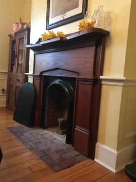

The dimensions of the room are 15'x15' and attached is a pic of what is currently there. I realize that this will take significant work to make this safe. I fully intend on removing the wood surround, stripping off the drywall and framing to brick, installing cultured stone, and building a concrete hearth.

That's a beautiful mantel and judging by the dining room furniture it suits the room well. I would be careful with the remodel. A cultured stone look could completely change the character of the room. Instead I would suggest trying to stick with the formality of line and formal style of the room. A nice castiron surround insert on a plain wall may work better. Or perhaps a complimentary tilework with an outside dark wood frame framing the opening? Some options to look at in the Regency line would be the Hampton HI200 insert (15" deep, but a tile frame could provide a 1" build out) . Others to consider are the Jotul C450, or Vermont Castings Montpelier,
