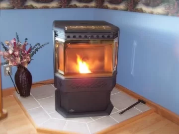

Well it's finally installed. Our very first pellet stove. We decided to go with a Napoleon NPS40. Nice stove, easy controls and puts out some good heat. Hopefully I got the picture to work with this entry. Anyway, I only have one ton in the garage with another two on order so I don't quite qualify for PP status, but I'm working on it.

A good looking stove for sure.
I do have to wonder just how clean all that glass is going to stay but then I guess most stove glass is bound to get dirty after a while.
I hope you have a long and trouble free experience with your new stove.
We actually had the stove installed last week, it took me this long to get a picture. The glass stays clean for at least two to three days, then a simple wipe and we're going again.
Your installation looks great! Others have mentioned having to drill out a larger hole in the burnpot for the ignitor on the NPS40. Did you have to do that?
I hope to install mine this weekend and don't know what the diameter of that hole is supposed to be. Thanks.

Thanks for the suggestion of the surge protector, will take care of that. I did not have to drill out the hole. I believe that Napoleon has take care of the problem. The stove lights easy and throws off good heat. I'd buy another one.
