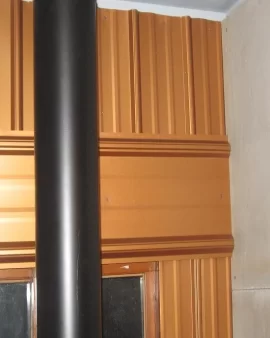

What is behind the stove? The photos seem to distort what it is. From how I see it it looks almost like wallpaper made to look like wood paneling, but I don't think that is the case. And is that a window behind that stove or a mirror? Something in that photo is messing with my eyes and I can't figure it out.
The rear wall is actually bronze colored metal roofing installed on some spacers as the ribs in the metal allow for airflow. Then I cut 2 12" pieces to finish off around the window and put that over the other. The wife wants a curtain on the window but I think it is too close. it is outside the 6" minimum though. As for the "logs" they are cedar slabs installed on a stick framed wall throughout the kitchen.

That is a veritable 'Temple of fire'. Nice work. What creates the moulding effect on the horizontal pieces?
