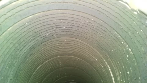

The main reason for the thread is I need a sanity check on what my chimney liner looks like. It's an external chimney, 18ft, lined with fully insulated SS liner. Like I said, we've been burning about 5 weeks now, including 1 week straight where we burned 24/7. Went up on the roof just to kind of check out how things looked. There was obviously some very, very fine creosote buildup (and of course the liner and cap were black), but it was so fine that it would almost fall off just by blowing on it. I've attached an image looking down into the top of the liner from the roof. What do you folks think? Keep on keepin on or do I need to make some adjustments? I know there will be SOME creosote buildup, but being my first experience, I am of course paranoid about any whatsoever that I see. Thanks!

Your fine if it worries you brush it out but that looks fine
Looks just like mine did day before yesterday. And I ain't going back up to look until April.
Burn on. You are doing fine.
Awesome - thanks guys! That's sort of what I thought, just wanted to consult some folks with much more experience than I have.
