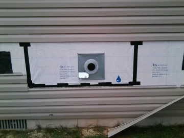

I hope this works, never posted pictures. Decide to post some early pictures of what I have so far. Last picture posted is the install of my old stove, at my brother-n-laws. [Hearth.com] New Install [Hearth.com] New Install [Hearth.com] New Install [Hearth.com] New Install [Hearth.com] New Install [Hearth.com] New Install [Hearth.com] New Install

[Hearth.com] New Install [Hearth.com] New Install [Hearth.com] New Install Finally finished up my install today. Will let the silicone on vent pipe joints cure for 24 hr. till tomorrow & fire it up. Can't wait! Suppose to get colder by end of weekend. Will have it finished up, just in time. Praying for NO issues with new stove & install tomorrow.

Looks like you ran into a stud where the thimble needed to go? I have the same stove. You wont be disapointed . As for the caulk taking 24hrs to cure dont worry about that. When i did hvac we all started using hi temp silicone on boiler and furnace clean out plates and smoke pipes. We started them up instantly after our annual service cause we couldnt leave a customer with no heat for 24hrs. Returning the next year the caulk was properly sealed and strong as ever. Nice install. Somebody mentioned something about drilling out the holes on our particular burn pot to help the ash drop out of the pan.im hesitant to do this. But these pots tend to hold alot of ash and build up quick. See how it does. Good luck

Yes that was the case. So stayed to right of stud to build my box in wall for thimble plate clearance mount. Didn't want to disturb or cut a stud off in the wall, wasn't to keen on doing that, but it all worked out fine. Other than my corner hearth plate that I used in old home as a corner install, it didn't turn out to bad. Didn't fell like buying a new hearth plate at this time. They can be salty, unless you have the time to build your own. With the purchase of new stove this year, will use as is and maybe buy a new one for next year.

I ran into a stud with mine. And the stove to the side of the stud looked bad. I ended up cutting the stud and using a header and jack stud system around my thimble. Came out nice. You did a good job. I love the ap5660l
I got lucky in a similar situation. I knew installing straight out of the outside wall was gonna be tight with a window on the right and a short inside wall on the left. I didn't want to install a heat shield on the left. I found the stud for the window and cut right next too it. Didn't even think to check for a second stud less than 18 inches away. Turns out there was one exactly 7 inches. The thimble just barely fit with a little swearing and jimmying.
