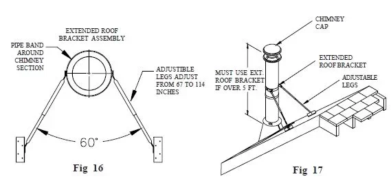

I'll be doing the floor protector and wall heat shields myself, but I have asked for quotes from 2 local shops for the chimney install. I am a bit fuzzy on how a properly sized chimney is mounted on a mobile/bungalow like mine. On an Osburn 3300/Drolet Myriad III it calls for 12 feet of flue system from the top of the stove. The PE Summit says minimum system height is 15 feet from base of appliance (I take that to mean the bottom of the fire box?).
Either way, I have a ceiling that vaults from 8' to around 9'6". The stove will be going near to the outside wall, so barely more than 8' floor to ceiling. That will make for quite a bit sticking out the top of the house. How much will this complicate cleaning? The house is fairly exposed to wind; what sort of bracing should the installers be using?

Both of the mentioned stoves are large and work well on a shorter chimney. I would suggest that you look at the Drolet Baltic instead of the Myriad. It has side shielding like the Summit for closer clearances.
How well insulated is the home? 6" or 4" walls? The more centrally located the stove is the better. The chimney will need bracing at the 5' level above the roof.

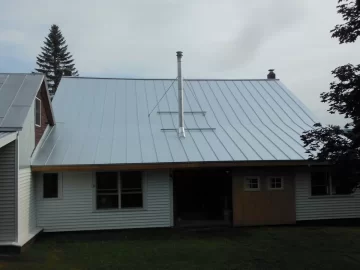

View attachment 277348View attachment 277349
How did the double snow bars hold up on this roof. any damage to the chimney or rods at the roof connection ? Thanks.
No idea, this is just an example picture found on the internet.
