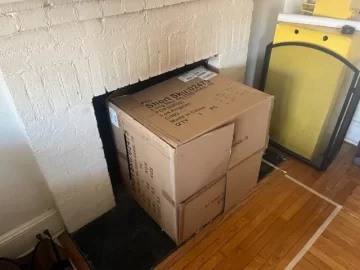

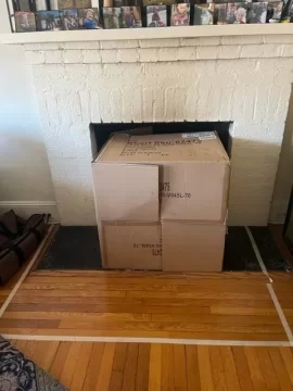

Pictures are below. The carboard box is very close to the size of the stove; the box is about 1.5” taller than the stove, and 1.5” narrower. We are ordering the stove with the rear heat shield and short leg kit. As you see it’s a very tight fit, but it seems to me like a perfect fit. It’s tough to see but electrical tape on the side show depth to rear leg. The side door should open greater than 90 degrees, although not a full 180 (or whatever the hinge limit is). The front legs will come right to the edge of the concrete hearth (that is framed beneath) but I’ll need to build the extension for ember protection. This stove has a bottom heat shield. The masking tape outlines the required clearances, but I’ll go bigger on the right side to make it balanced (even side to side) and if it’s a hair deeper into the room to accommodate tile size that’s fine. I’ve never cut nor laid tile before. The dimensions in front of the chimney facing are 38” deep by 68” wide.
Questions / considerations:
The tight fit means it will be difficult to clean out the liner from the bottom, correct? Any other observations regarding fit? I am just concerned because there is little wiggle room on this.

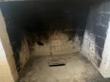

Construction of the hearth has been discussed extensively on these forums and I feel like I can do that myself. Cement board, thinset and tiles seems like the popular choice. I also intend to paint and seal the fireplace as best I can, and need to do something about the old ash catcher.
