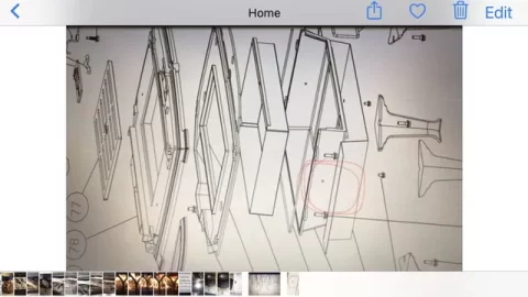

Before starting the fire I cleaned everything really well looking for problems. While cleaning out the ash pan area I notice two 1/4 inch holes in each side of what the manual calls the Ash House Assembly. One on the left side and one on the right side. I shine a flashlight through the holes. Yep, they go all the way through. I start the fire and when it's once again burning hotter than the fires of Hell I put a magnet over each hole to cut off the air flow. Well, what do you know. The stove top is now sitting at 450 degrees. The stove pipe is 425 degrees. The Cat temp is now 1100 degrees. The cat is glowing a dull red instead of almost white hot. The fire is burning lazily just like my old VC and the stove isn't eating wood like it's candy.
Any thoughts you folks have on this would be greatly appreciated.

Glad you found the culprit, primary boost air holes tend to do that with a strong draft. I wonder if this is the cause of the premature cat warping that has been reported on this stove? I covered mine on my F45 and have much more control and longer burn times.

Is this 1 of the ports?

Nice find. I had the same experience with my new F500v3. I have a 29ft chimney and ended up installing a key damper to get a handle on my fire. Total control now. I'll add a magnet to those two holes now as well.

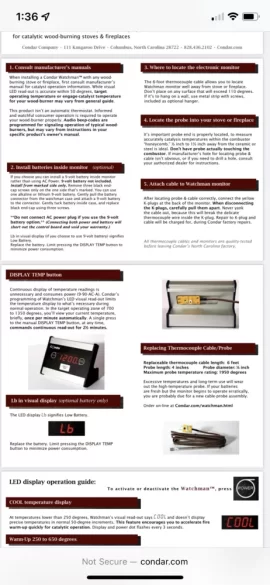

Update 3:
Under the heading of "It's always something"...... I ordered a Condar Watchman Cat temperature monitor but the probe won't fit into the hole. The shaft of the probe that came with the stove is 5mm in diameter. The probe that came with the Watchman is 6.5mm in diameter. AARGH!!!
I knew that there are different probe lengths but I wrongly assumed that all probe diameters would be the same since I haven't seen probe diameter listed in any specs. I REALLY don't want to drill out the hole in the cast iron in a brand new stove.
Thoughts? Options?
Send it back, sell it on. Maybe an Auber? I really like my two. One is the the wireless version.
Thanks for the link.
Would it be correct to assume that an Auber K type thermocouple with two lug mini connector will work with a Condar Watchman?
Confirmed: The Auber TC-K-BR probe does indeed work with the Condar base unit. I tested both the Condar probe and the Auber probe in a 400 degree oven and they both register the same temperature.
I slid the probe into the hole in the Jotul and placed a magnet on top of each side of the probe mounting bracket to hold it in place. It's supposed to get cold here tomorrow so I'll fire up the Jotul and test it.
