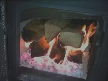

Glad things are coming together for you! I cant post a step-by-step for you now but here is what my firebox looks like this time of year before I go to bed. In the next couple weeks, once the day time high drops to around 38, I will really manipulate the space in order to fill it snug (i figure I can pack about 8 splits if I really need to).

Thanks BuffyGirl . . . always nice to know someone appreciated the time I took to post a thread with pics . . . or a thread with lots and lots of words.
The pictures really help - we have such a strong draw with the new ss chimney - it's over 30' tall we are starting out slow - only about 3 good sized splits at a time -- learning how to throttle down the air intake so it doesn't run away with us - so far am comfortable with the stove around 450 during the daytime but I know I will go higher as the temp goes down. Still working on the night burns a little scared to fill it up too much -- but I'll get used to it. It's a beautiful stove and burns very clean.
