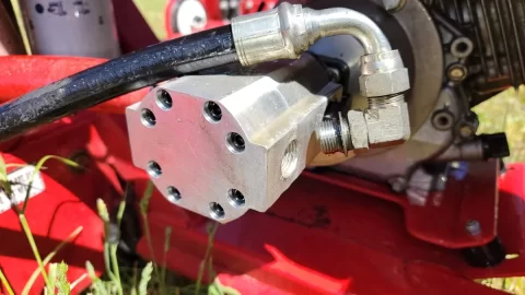

I bought one of the 16gpm aluminum body pumps that are all over. Description says outlet port is 1/2 inch. I replaced a 11gom MTE on a Barreto log splitter.
First log the thing explodes and pushed the fitting right out of the threads.
The threads are partly stripped. I can move the fitting in and out no screwing now. But there is still threads left inside.
What gives? Are these some different thread size than the 1/2 inch MTE pumps use?
Or is this just defective?

If it was fully threaded and not leaking I'd guess just a bad part.
It threaded in by hand easily. When I tightened the lock nut it seemed soft. Like it was stripping so I didn't make it to tight. It didn't leak until the high pressure kicked in and it went BOOM and what a mess. I thought about bringing it to a hydraulic shop to see if it's some other thread size or having it tapped but I prob should just return it and buy the Dynamic pump my local shop sells for 2x the price.

I called a hydraulic supplier and they stated that all the pumps are half inch npt out. And that that fitting is straight thread with an o-ring and that it's not compatible?
That's how it came from the manufacturer and it was working on an mte pump.
Is this true? Do I need a different fitting?

If that pump calls for a NTP fitting the one you used is straight cut with Oring is not going to work. If it didn't ruin the threads in the pump you can buy a fitting with NTP male and JIC or what ever fitting you have on the hose end. They also make bushing that will go from NTP to straight cut O ring also. Look on Surplus center web sight.

So you guys are right. I have the hydraulic shop get me a npt to jic elbow and it worked okay. I presumed all these log splitters pumps were the same since they all specify half inch in this class. I didn't know that they were using different thread types.

Sounds like there was no problem with the pump. The original fitting was not compatible with the port that is commonly found on splitter pumps.

yep, threaded straight threads into NPT. Should have known when
That should have been the red flag.
