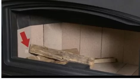

The Ignitor works and looks like a pellet stove ignitor using AC to super heat room air pulled in to 1400 Degs. This lites the wood in one minute and takes 15 mins for normal startup. Ignitor can also be used on a reload to refresh the fire for faster reloads!
Have to get the kindling next to the ignitor hole! see red arrow
Sure works well when the stove is brand new!
