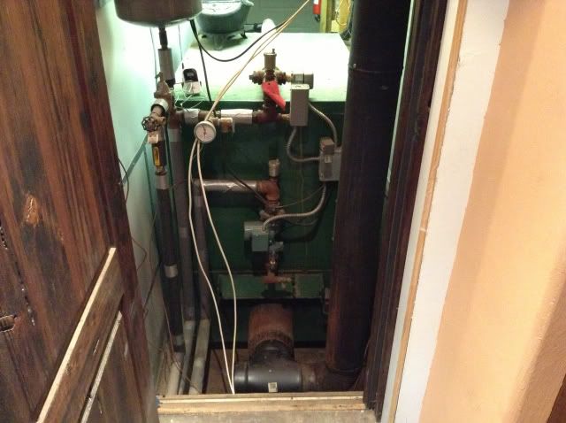

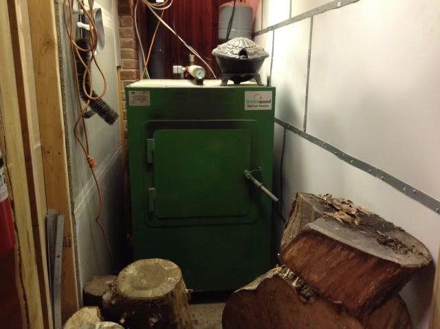

Hi everyone, happy to have found this Forum, just wanted to share a couple of thoughts regarding our Greenwood 100.....I am a builder and contractor (down state NY) got the idea about 3 years ago to incorporate the Greenwood 100 into my Buderus Oil Fired Boiler...I am on year 5 of a large scale Reno on our 4000 Sqft house....(Wife is a Saint)...this past week is the first week the Greenwood has been used to heat Via our radiant.......I went through one winter with a cieling hung 32000 BTu Garage type Blower hung from my living room cieling....the Greenwood had to be fed a lot, that type of unit is anything but efficient...
A couple of things to note about this part of the country that I am in...THERE ARE NOOO WOOD BOILERS, and very few people that know anything about them......the people around here that I have been working for for 30 years want nothing to do with anything that involves extra work, they have the $ for oil or gas and just want to hit a button , actually they would rather have their housekeeper hit the button....I tell you this because the learning curve has been steep, I work with solid Plumbers, Electricians Etc,,,,and my main plumber designed the system but he used his general knowledge because he had no specific knowledge of wood boilers.....I am happy to report all is well, third full day of burning, nice white interior, very little emission, no smoke as long as I open the door to load when the damper is open...we have had some 16deg nights, I get about 6 hrs when the Greenwood is wide open....so far, I Love it.....
My reason for joining are twofold, one to thank you all for being here, I have read a lot and good solid non bias info is hard to come by....secondly I have read about many unsatisfied Greenwood owners.....it's unfortunate but I think most of the problems stem from poor install and design.....some people come on and say...." we had it professionally installed" that in my opinion means nothing, my town is full of "PROFFESSIONALS " that I would not let wash my car....These installs as you know are all site specific, very finicky, and for a very simple principle can go off the rails very quickly......we may have gotten lucky, the stars may have lined up, but so far this unit is great, it's becoming an obsession, checking temps, in the basement, out to the shed, load a massive round, middle of the night, I really love it......my oil gauge has not moved, and I am heating with wood.....All is good in the world.....Thanks Again. Maybe I will try to get some photos up.... G

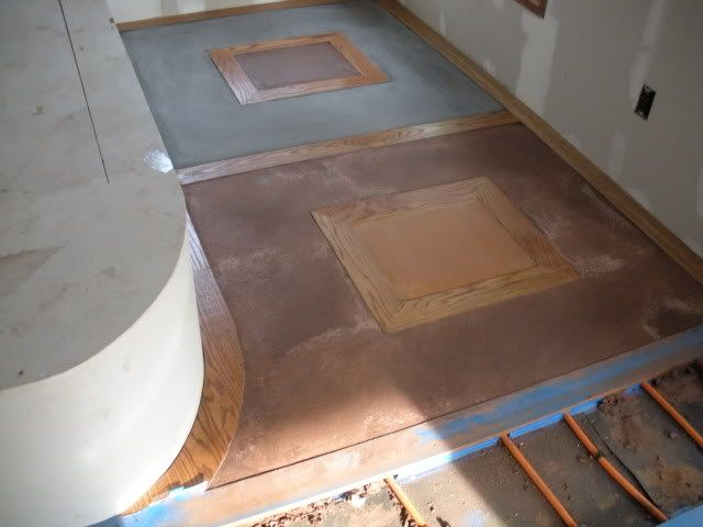

Welcome to the forums! Do you have any type of return protection for the boiler? You mentioned radiant, is it a wet (in some type of slab) or a dry system (suspended under subfloor).

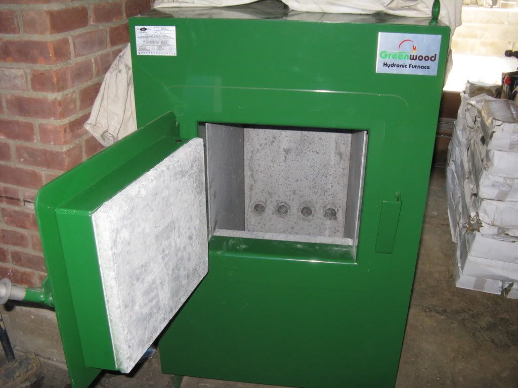

GW/Seaton designs need dry wood and hot return temps to work reasonably well. The biggest flaw in the design is the total lack of a sealed fireside system. The skins need to be removed for one dirty awful HX cleaning. If kept hot they do work pretty well, let them idle and forget it.............worst boiler out there to idle (not that any should).

I will eventually get some more photos up......radiant is in concrete, I am a Concrete Fabricator, countertops, Floors, etc....I am just now running the system less than wide open, we have been hovering around 33Deg most of the day....I have a wireless Redi Check strapped to the feed and return on the back of the Greenwood......the sweet balanced numbers seem to be 153 out 142 return, I never let the return go under 130, this seems to keep things White and Hot. I just settled on this 130 return number, I experimented with lower but I sometimes would need to begin a reignition process, At 130 return I can put in one or two split pieces and a Large round, 15 minutes later my numbers are back to the 150's out.....how do those numbers seem to you? Thanks for the Welcome..
The general accepted lowest return temp for any wood boiler is 140, I like to see at least 150 coming back to the boiler for extended times.

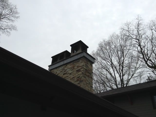

Been burning and keeping a close eye on everything for the last month, a couple of days ago I started to get a strange smell from the Greenwood....almost like oil!!...figured maybe it was the wood, new batch, just keep an eye on it I thought. I have also been closely watching the water temps in-out....last night water temp went up 2Degrees higher than ever before, also my water temps where holding steadier, the house was warmer, my burn times where lasting longer, I was happy, but confused. So this morning I decided to let the fire burn down and get a closer look at things...Now let's back track two weeks ago,, after staring and obsessing about how this thing works for the last month I noticed that while I was burning pretty clean, there was still good heat going up the chimney. I started to think that if I installed a damper in the flue and closed it at just the right time, I would lock the heat in, so I ordered an inline damper from Amazon...Now back to this morning, I get up on my roof 8AM before the snow, approach my custom made concrete chimney cap with Stainless Steel Mesh....as I get close I realize the mesh is clogged up pretty good, I lift my cap, inspect the flue, not bad, but the mesh, Totally clogged....(working like a damper)..I cleaned things up, swept the chimney, fired it up again, no smell, Great draft....this confirmed the usefulness of the damper, I think it will really extend my burn times and increase my efficiency....will post again after the install and post a few more photos...it's a learning experience for sure...
That tells me you're sending crap out your chimney. For every grain that got caught in your screen thousands more went into the air. A damper will more than likely cause the fire to burn slower albeit colder and put more crap out the stack.

The caps I built are concrete with stainless steel mesh with 3/8" holes, it's a little tight, I also have been burning off some of my older uglier stuff first, I only smoke a little at ignition, if the mesh had larger holes it would not have clogged so easy....the flue pipe had a very light coat after 5-6 weeks of 24-7 burning....
Also the closing of the damper has to happen only after most of the initial burn is done, not while full burn, there should be no smoke when the damper is closed, at least that is the plan.....

How tall is your chimney? Does it have a barometric damper? I'm suspecting you have too much chimney draft. Magnetic guages also read way low - when I'm burning, my probe guage reads around 200c. The magnetic right beside it reads 100c less. A Dywer Mark II Model 25 might be a good investment for you - along with a good internal probe. And likely a barometric damper. Does the manual say HOW flue temps should be measured?
Cement chimney caps with SS mesh....single Is Boiler, double is FP and Oil fired boiler...three flues.
